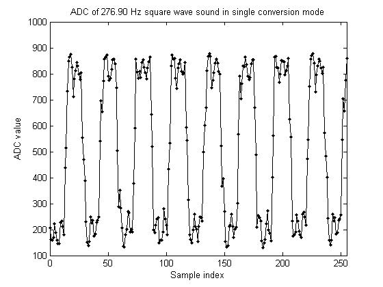

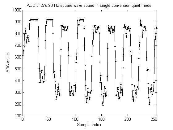

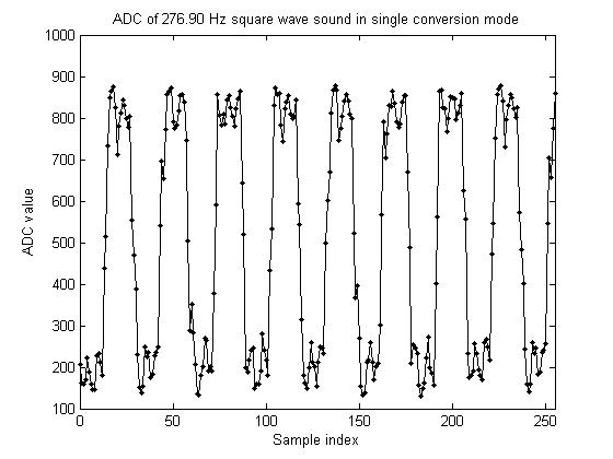

> Hello Pepe, > > of course I would like to know more about. The Free-Running-Mode > has the disadvantage that we must poll over the interrupt flank, > because there is no way to define a real interrupt routine. > That causes a lot of cpu-noise. Maybe we put the cpu into > ADC-Sleep-Mode and wait for the result. In ADC-Sleep-Mode we can > use a faster ADC-Clock. Please take a look at the program below. > > DancingProBot-0.01 > > GruÃ? Torsten Hi Torsten, Im am afraid the other running modes you programmed do not work so well as the free running mode. - ADCaptureRun runs 15% slower than ADCaptureRunFree and shows some glitches. - ADCaptureRunQuiet shows strange behaviour. See attached figures. What do you think? What might work is an 'ADCaptureRunFreeQuiet'. Regards, Pepe Sound data in single conversion mode.JPG: Sound data in single conversion quiet mode.JPG: | ||
